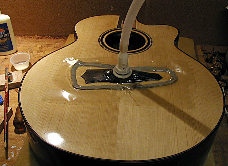

I use vacuum bridge clamping, but I did not pay the $80-some for the LMI unit. A foot and a half of sealing mastic strip (reuseable), a small scrap of nylon vacuum bagging film (we use both of these vacuum bagging wood/epoxy kayak hulls) and a $4 plastic fitting to attach the hose to the film, and that's it. Very simple and works great.
